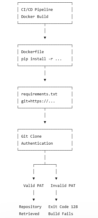

How It Works: From pip to Git Authentication
Understanding the request path makes troubleshooting considerably easier.
This explains why the failure may appear at:
pip install -r requirements.txt
even though the underlying problem is actually private Git repository authentication in Docker.
