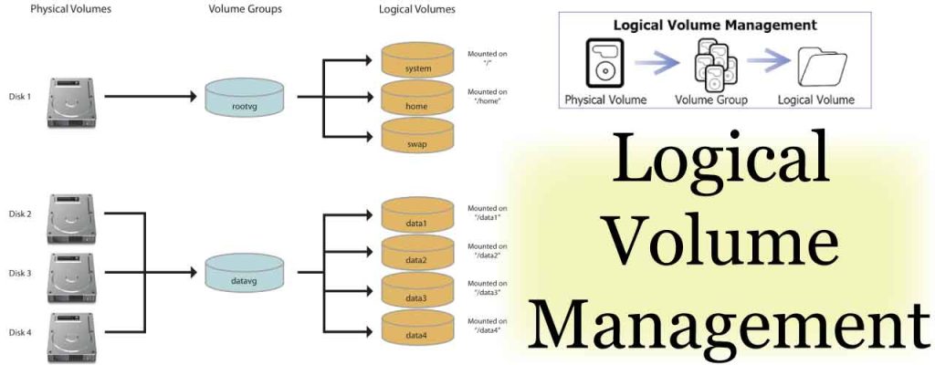

How to Increase the Size of the Logical Volume ?
logical-volume-management1
Follow the steps below to increase the size of the logical volume and allocate additional space on one of your partitions.
